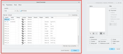

Anyone have ideas how to show system dialog Select Parameters from toolkit application?
This dialog is using for selecting parameters for family table and in Inheritance feature.GUIGUI

In Pro/TOOLKIT, the method is "ProParameterSelect".
In ObjectToolkit, you can run "SelectParam" or "SelectParams" on a pfcModel object, or pfcModelItem object.
FYI also - if you'd like to then apply the parameters to a FamilyTable, you can use "ProParameterToFamtableItem" to apply it into the family table operations.
