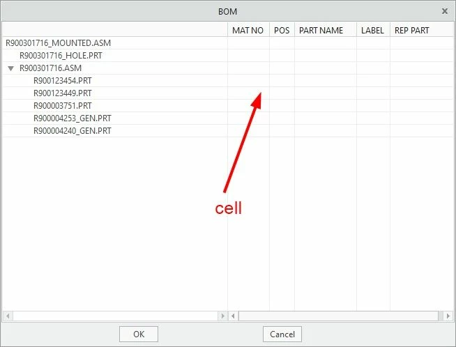

How to show values and modify them like "ProUIInputPanel" in the ProUItree cell by tookit API?
I got a problem to using ProUItree in dialogue. Does any one have the solution ?
1. How to show values in the ProUItree columns cell by Protookit API when initialization?
2. When I click the column cell in the ProUItree , how to edit it like "ProUIInputPanel" by Protookit API?

Maybe, a funtion ProUITreeInputpanelAdd() will help you.

Thank you very much. It works now. 😀
err = ProUITreeInputpanelAdd(dialog, "TreeBOM", "ipText"); //********Create the "Inputpanel" in the Tree *****************
err = ProUIInputpanelValueSet(dialog, "ipText", L"Hello"); //********Set the string in the "Inputpanel"  *****************
err = ProUITreeNodeComponentSet(dialog, "TreeBOM", "1","ipText", "column1"); //********Show the "Inputpanel" in the cell of defined column*************
