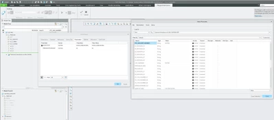

AnthonyC12-AmethystAuthor
Jan 11, 2023 3:32 PM UTC
thanks for the fast response.
You will have to be patience with me, as i am fairly new to Creo.
I am unable to add the PTC Part number or the CAD number (which matches the PN) to the varied items field. i assume its something to do with them being locked and auto generated by windchill, as i could pull two values that i create.
I suppose i need to somehow create the relation of the original PN, have that as a parameter in the new/machined PN.
