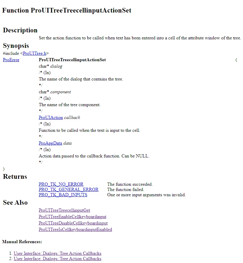

The documentation in the Toolkit Guide found the following related functions to implement:
ProUITreeenableCellkeyboardinput (true)//Allow tree controls to respond to keyboard operations
ProUITreeTreecellinputActionSet()//Set the response action for the control
ProUITreeTreecellinputGet()//Get input text
ProUITreeNodeColumnntextSet()//Set text content
But the result is that the operation function was not called after calling ProUITreeNodeColumnntextSet to set the text content
Can anyone with experience explain how to use these functions or provide sample code?
