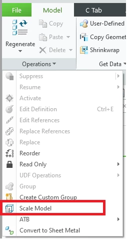

How to use the TOOLKIT or Object TOOLKIT to scale model ?
Without using "ProMarcoExecute" and "RunMarco" , how to use the TOOLKIT or Object TOOLKIT to scale model ?
I have been looking for the "Scale Model" function in the API Wizard, but unfortunately, I did not find it.
Why don't I want Marco's way to execute "Scale Model", because the TOOLKIT or Object TOOLKIT program will lose control of CREO after executing marco. Is there a way for the program to keep control of CREO?
