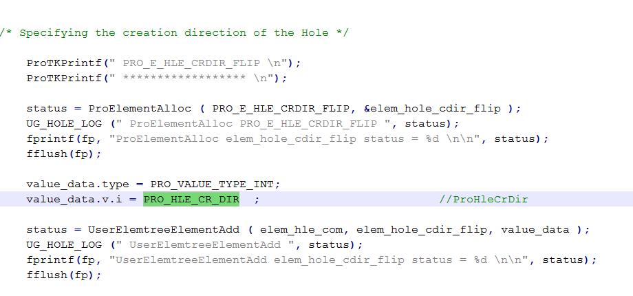

I am trying to create a tapped hole using toolkit. I am clueless to what should be the data value for element PRO_E_HLE_CRDIR_FLIP ?
I am trying to create a tapped hole and following the user's guide of toolkit.
The error I got after compiling my code is: "PRO_HLE_CR_DIR : undeclared identifier"
How can this problem be solved? Can anybody help?

PRO_HLE_CR_DIR is a enumeration. You need to use one of the enumeration values. For example:
value_data.v.i = PRO_HLE_CR_IN_SIDE_ONE
The enumeration is defined in ProHole.h:
/* PRO_E_HLE_CRDIR_FLIP */
typedef enum pro_hle_cr_dir
  PRO_HLE_CR_IN_SIDE_ONE = -1,     /* Std/sketch hole creation in side 1 */
  PRO_HLE_CR_IN_SIDE_TWO = 34      /* Std/sketch hole creation in side 2 */
}ProHleCrDir;

Thank you Gabriel very much. It worked. As you might have guessed I am new to coding and learning toolkit. Your help is very much appreciated.
