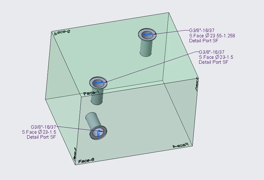

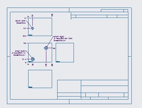

I am using Creo 10. I have a number of udfs meant for Hydraulic Manifold Block design ease. It is all independant udfs. I had started developing them from about 2005. It includes BSP/NPT ports, angle holes, holes within holes, cartridge cavities etc. It comes out with its own 3D note which can be pulled into the 2D drawings, thus ensuring data transmissibility. Hole tables are also creatable, with hole coordinates in each plane being measured from the centre of the block. But this can be changed, if one so desires.

I would be delighted to give you a sample. I am enclosing BSP/NPT port udf for creo 10. The questions  asked by the udf are self explanatory to a large extend. It will ask you for :
Placement surface
Y - Plane
X - Plane
Body
after which it will proceed to place the port on the block placement surface. Once placed you can edit the X and Y dimensions to position to your requirement. You can also freely increase the depth. The depths of the port are always taken from the surface of the block to the tip of the drill (118deg cone angle). There is also a spotface provided for sealing purposes on the top (near the block placement surface). If spotface is not required, just click the default 1.5mm SF thickness, and make it 0. You can always bring it back later by changing this dimension later.
3D hole note is always provided, and will change description as you change, accurately. You can pull out these Hole notes in the drawing file (drw file) via the annotation feature. If you need higher than 1 decimal accuracy, there is a "acc" parameter which can be modified to provide greater SF depth accuracy
I am going to post you the port.gph file for your trial. Please use it and tell me of any difficulty you feel. I will clear all your doubts
