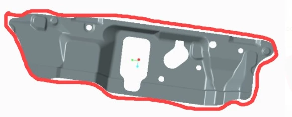

I would like to get the Outer contour of a Sheet body which is an IGES file imported into Creo.
Hi All,
I have to get this information using Pro/Toolkit. Kindly suggest a solution.
The boundary line shown in RED is what is required.
-Vijay
18-Opal
February 27, 2020
You would have to visit the surfaces and then the edges for each surface within the part and then tie them together by subtracting the overlapping edges... and then scanning for the extrementy.
