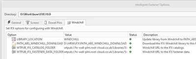

We have a new installation of Creo and Windchill., and I am setting up the system before rolling it out to our users. I want to be able to use IFX in a multi-user collaborative environment where everyone uses the same setup, thus having the same options. I also want to store the data in Windchill..
I have configured IFX to use catalogs of the fasteners we want to use, and I have created the dat and prt files to accompany this. The dat files contain all the instances that we need, and also adds specific parameters to the files on creation of the prt instance. All of this works perfectly when in a stand alone environment on my PC. (Thanks to Oliver of B&W for his help on this)

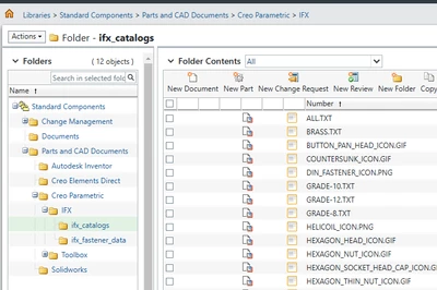

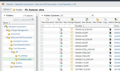

The problem occurs when I try and enable the 'Windchill' options in the IFX options. I have uploaded the catalogs and data files to Windchill, and pointed the options to these folders:

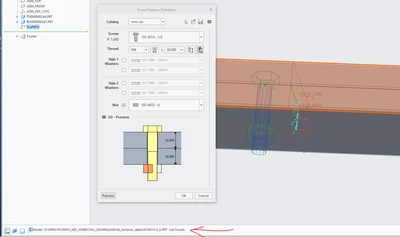

When I start IFX, it creates the folder ‘PATH_ABS_WINDCHILL_DOWNLOAD’ and populates the sub-folders correctly with the catalog files and the .dat files. However, none of the .gif, or .prt are downloaded, and so IFX cannot find the prt seed file in order to create the fastener:
If I manually copy the seed prt files in to the download location, everything works fine. I conclude therefore that for some reason IFX is not downloading the whole contents of ifx_fastener_data from Windchill to the download location, only the dat files.

here are the answers to your questions:
1) Is the above the expected behaviour?
Yes, this is expected behaviout.
You only can download the *.txt and *.dat files from Windchill.
The images must already exist in PATH_ABS_WINCHILL_DOWNLOAD
The *.prt files should be removed to ensure that only existing parts (already uploaded) are used and IFX cannot create a new fastener on the fly.
If you use the PATH_ABS_WINCHILL_DOWNLOAD approach, you should use the IFX-Instance Creator and upload all your fastener instance prt to Windchill.
2) How do I get IFX and/or Windchill to use/find the correct seed part files?
If the fastener instances from your *.dat file are uploaded to Windchill, then IFX can reuse the existing parts.

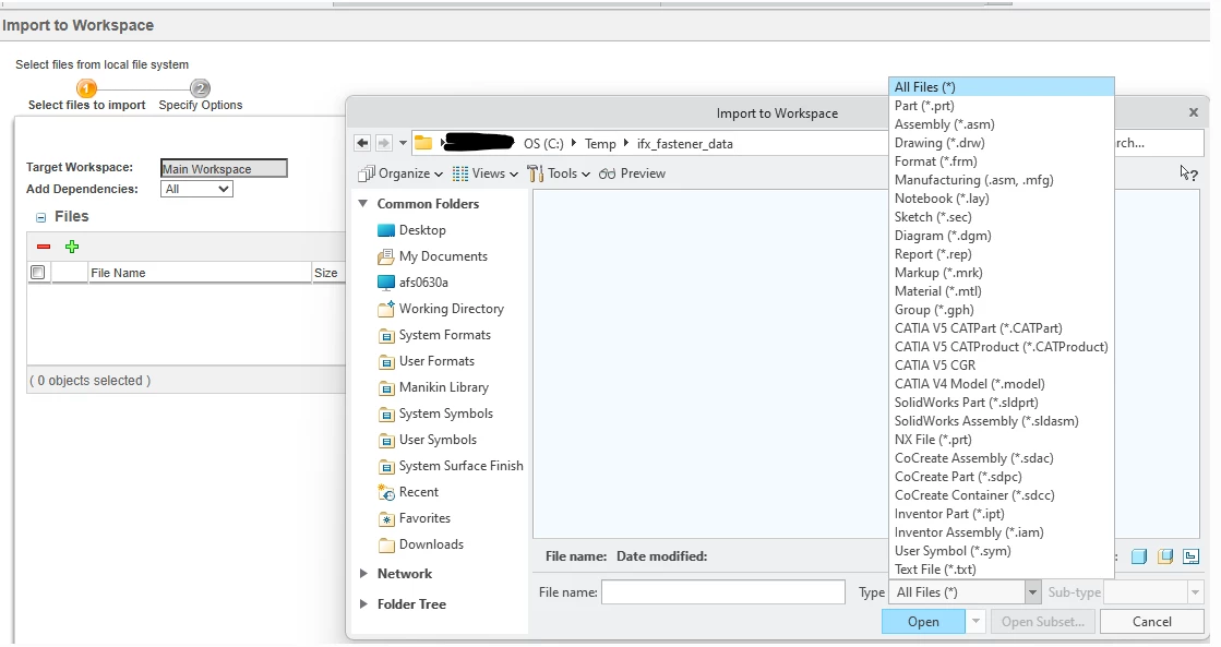

Hey!
I am trying to do the same thing (move IFX fasteners to Windchill) and I am stumped on this part: I can’t seem to upload the .dat files to Windchill. When I try to upload them to Windchill in a web browser, it tries to create them as a Document object. However, it seems like IFX can’t see the .dat file contained within a Document object.
When I try to import the .dat file into a workspace from embedded browser within Creo, the .dat files do not show up in the file dialog box so I cannot figure out how to move past from here. I even added dat as a MIME type but that didn’t seem to give me the ability to import it into a workspace.
