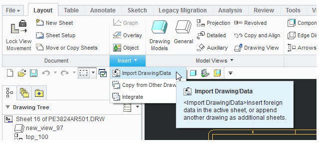

Hi all,
we have two assembly models A & B.
One sub assembly ( called as C) is placed in both A & B.
Drawing of assembly 'A' contains muiltple sheets. In one of the sheet contains only the details of sub assy 'C'.
we need to have the same details of C in B drawing sheet also.
Is it possible to insert a sheet from other drawings ? if so, please help me to do that.
Jan 2, 2014 9:25 AM UTC
I have resolved my issue by using the following option
Thanks for your efforts
2-Explorer
Dec 31, 2013 2:02 PM UTC
In WF 5, Edit ->Copy From Other Drawing. It opens a menu that allows copying detail items or entire sheets.
Jan 2, 2014 8:54 AM UTC
Thanks David.
I need to have the entire sheet including the 'C' part Drawing views along with dimensions. It it possible?
Also I am using CREO 2.0
rrangaswamy1-VisitorAuthorAnswer
