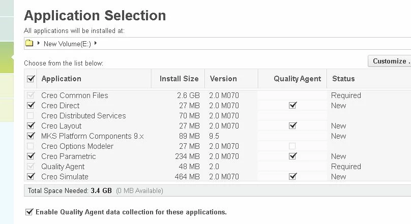

Installing at a different drive than C
I am trying to install PTC creo to another drive because C drive would not have enough space left after installing. I am unable do to so, because at install window when I change drive letter, it says that 0 MB is available wven when there's plenty of space at the other drives. Please help

Have you tried pressing ENTER after typing new drive letter? It's not obviuos, but without it installer won't check new target directory for free space and won't let you proceed with installation.

I can install Creo Parametric 2.0 on any disk. Can you show us detailed properties of your E: disk ?

It worked after pressing "enter" after typing the install directory address. Thank you so much for the advice !
