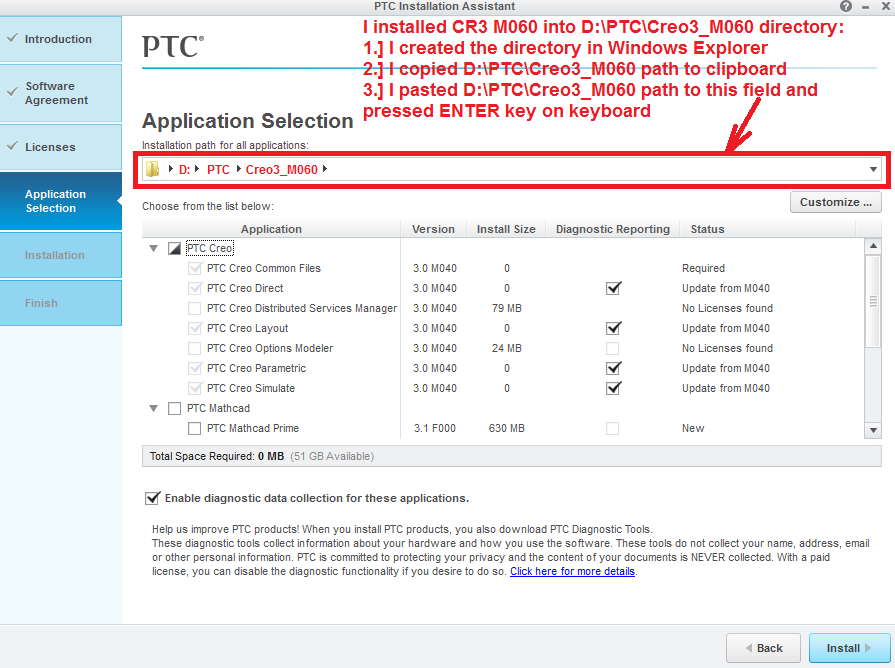

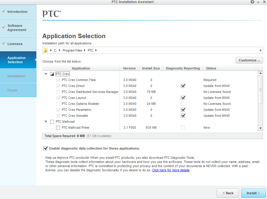

I am trying to install Creo 3.0 in E:\Program Files\PTC, but it keeps defaulting to my C:\ drive. The only time I can see it prompting for a install location is here:Creo.png
No matter what I put in the "Installation path for all applications" box, it ALWAYS installs in C:\Program Files\PTC (after trying three times now). Any way to either reinstall to the proper location, or perhaps move the existing install without manually redirecting all the shortcut paths and registry entries?

I do not know if it is true or not but I read somewhere...
If you put the location in, be sure to hit the enter key to lock in the location.
just maneuvering to the location is not good enough.

That is correct, you must 'lock' in the location with an Enter.
