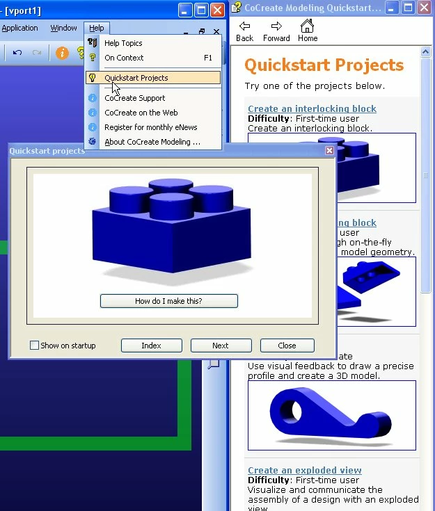

Hello, I cannot (fully) use the ten "In Depth Tutorials" I have downloaded and installed. The index of the tutorial is visable in the left pane of the reader but the content isn't shown in the right pane of the reader. I am using Vista 32. I learned that the "ten tutorials" are compiled HTML files (.chm). Do I need a special kind of reader? Furthermore. It would be nice if the "ten tutorials" could be accessible from the CC-PE help menu, just as "Quickstart Projects". What must I do to get going? Thank you in advance for your response. Kind regards, Henry Janssen
January 26, 2010
Hello, the pages can also be accessed thru the Help Button in the upper access list. Help - Quickstart Projects. In the next window you may use the "Index" button to get a list. Or you move to the next project. The only item I'm aware of is that Windows is restrictive to show chm files if they have been installed on a remote server or network share. Tests recommended are to use the local installed Modeling PE Help (see above) or to install the download files in a local directory without restrictions. For reference: One can download the Quickstart Models as well as the tutorials from our web page at (Being registered) http://www.ptc.com/products/cocreate/modeling-personal-edition/
