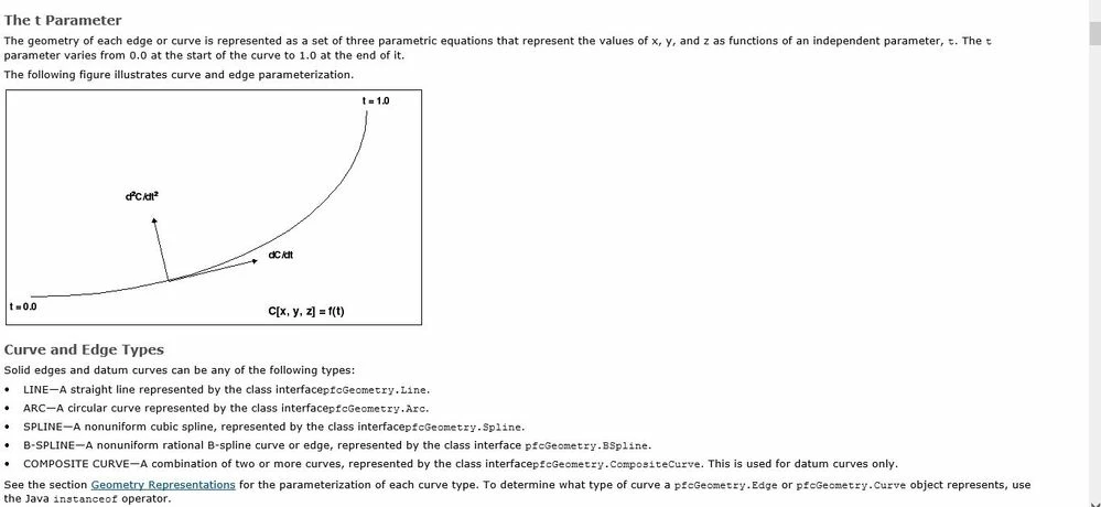

can't totally get you meanning, however, i think you may need the Interface Geomentry curve, you can get the curve 3D data and export to .csv file or other.
July 1, 2020
My intention is to get a vector of curve points or something else which describes a curve in my CAD model right from Creo Parametric. The screenshot you sent me is from a Toolkit documentation, right?
Anyways, I didn´t really manage to find any function in Creo Parametric to get a definition of a curve which I can pass to a csv file in "external analysis".
