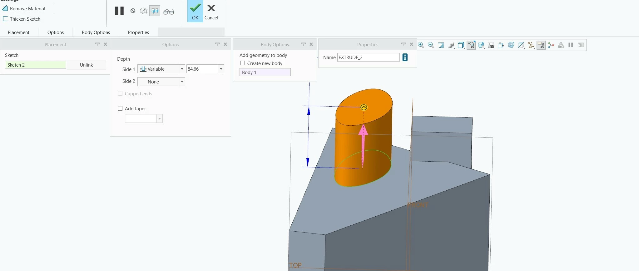

I would like to participate if there is a chance. For sure creo is made to be quite adjustable to personal setups , also made to control every possible detail, but initial typical workflow of creating features and building models and working with tools is not intuitive and its somehow overmade.
Here is my first both question and suggestion , why all of tthe tabs cannot be in one neat box or in main row  box?   by default all are closed , and processing setups asks 8 mouse clicks , that could be reduced to 4 .

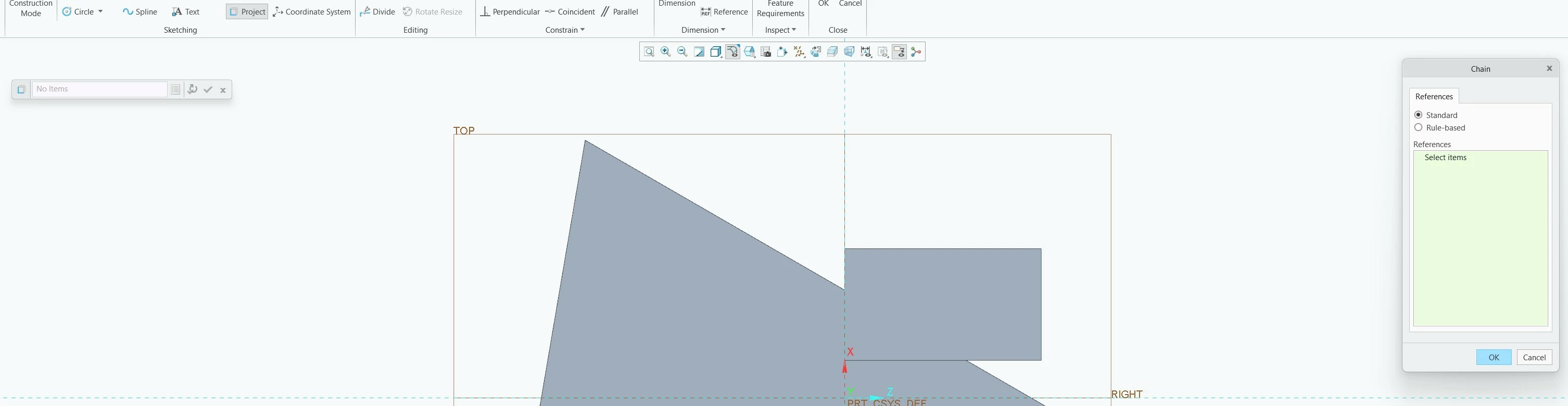

then , in sketcher the tool project or offset, why the popups fly from edge to edge of screen? chasing them all the time, why not instantly open next to eachoter or fully open for edit somewhere?

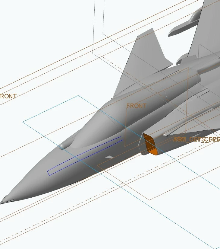

and my biggest desire for sure would be an option to adjust the thickness and visibilty of style and sketch curves in general viewport. most  of the monitors are now 4K and line thicknesses are not adjusted well for 4K monitors.

Line thickness settings would be a good idea here. I can only change color and line types. I think a line weight setting would be a good enhancement.

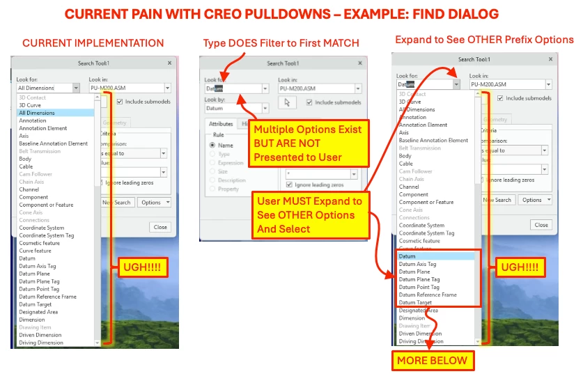

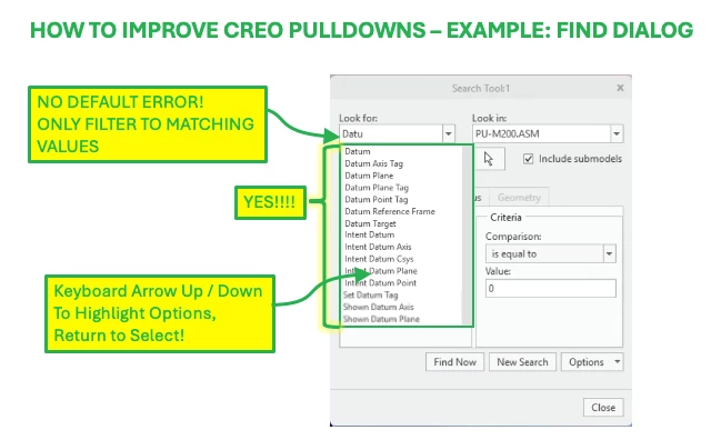

While we are at it… how about some text auto completion for any pulldown with matching items across the system… the “find” is a great example of this pain.  Long scrolls for selections is always painful.  Config editor needs this terribly also for searching current settings and finding new ones.
Can you give another example of how this would work?

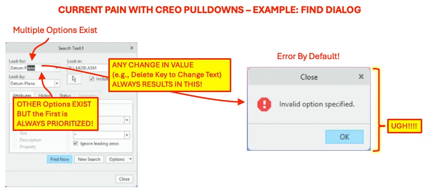

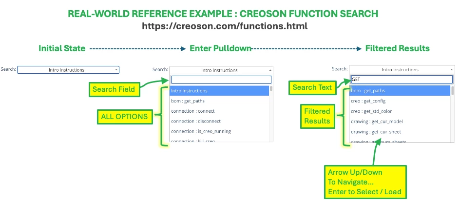

Sure thing - let's use the Find Dialog as a perfect example of UX improvement.
This is the current and proposed improvement for UX on this function - we need more keyboard less mouse… This will improve user experience by avoiding the users interruptions (errors) and manual scanning long lists of text/options for items that are matching what they are looking for.   This is a GREAT example because “Datum” appears mid-options on some of these - not just at the start of the option.

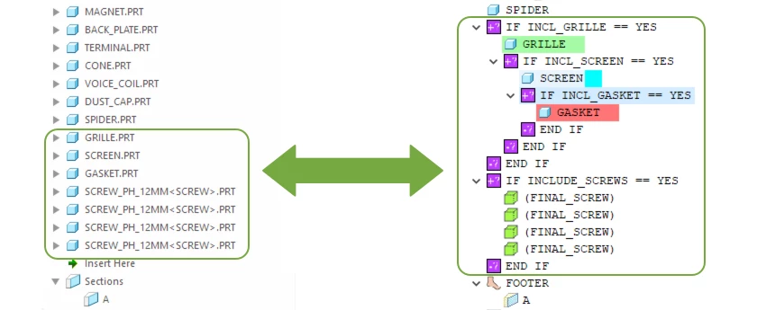

Maybe incorporate Nitro-PROGRAM into the model tree unlock Pro/PROGRAM as a first class citizen in the parts and assemblies?! 🤔🤔🤔

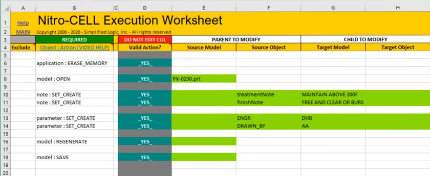

Nitro-CELL
  • Specifically developed to help users automate Creo Parametric (without being software developers)
  • Provides bi-directional interface between Creo / Excel to get/set data and perform operations.
  • Use Excel to define/manage Creo Automations with “obvious” user commands (e.g. file : open)
  • Excel Automations are independent of Creo Models (change management)
  • Excel is ubiquitous, portable, and independent of models/structure (everyone knows it)
  • A swiss army knife of optimized commands that enable consistent / repeatable operations/workflows
  • Enables user “processes” vs “clicks” to be captured/managed/executed at scale with less code
  • etc.

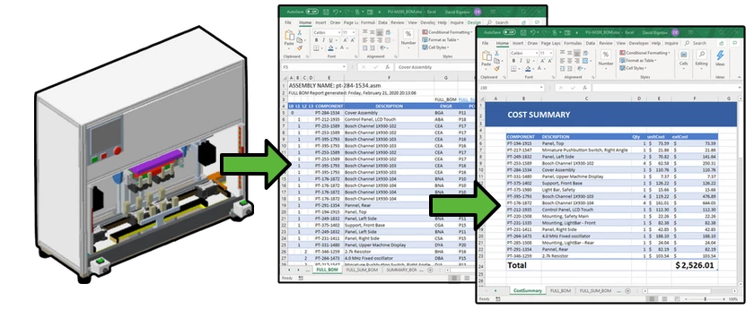

Nitro-BOM
  • Configurable extraction of Assembly BOMs and parameters to Excel Tables (multiple reports)
  • Bulk Creo parameter manipulations (create/delete/set/designate/un-designate) from Excel
  • Parameter Mapping (Creo Parameters → Target System Names)
  • Creo Excel Table BOMs are in Power Query by default (merge with ERP data for costs, etc.)
  • etc.
Nitro-PROGRAM
  • Drag-and-Drop Graphical Pro/PROGRAM Editor (Parts and Assemblies)
  • Shows all the hidden Pro/PROGRAM logic that should be visible and editable in the model tree
  • Visually communicate dependencies to reduce pain with trying to find them in a text editor.
  • Create/Modify/Trace/Test Parameters, Relations, etc.
  • etc..

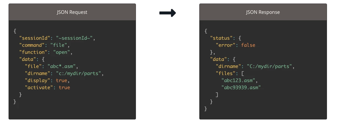

CREOSON - 13,700+ downloads as of this post!
  • 100% OpenSource - Blessed by PTC (Thank You PTC!)
  • Subset of our Commercial Libraries used to enable Nitro-CELL, Nitro-BOM, Nitro-PROGRAM
  • Created because 99% Creo Users are NOT Software Developers
  • Enables generic HTTP/ JSON Interface (programming/scripting agnostic - python most popular)
  • VB, C/C++, Java, JavaScript are ALL Heavy Learning Curves and massive Technical Debt!
  • Notice the wildcards (*)?! THAT option was my idea! (I just load/get/set/export whatever in session/directory/workspace and do things vs writing a bunch of process/evaluation logic to get prepared to do things).
  • Oh… and then I saw this a few weeks ago… Claude AI using CREOSON to automate interactions with Creo Parametric  https://www.youtube.com/watch?v=DOLniptMWCg ← Super Cool (wish I did that first) 🙇

The lowest hanging fruit for PTC would be to replace their current BOM process (which has never changed) with Nitro-BOM  - immediate win for them and their customers - removes friction enables faster results/interactions with data (local or enterprise).
Pro/PROGRAM needs to be a “first class citizen” in the Model Tree (parts and assemblies).  I would for sure fix some of the Pro/PROGRAM baggage that has been around for 20+years in the process (ahem lookup_inst, variables, execute statements, and those annoying input prompts).  BUT overall, PTC’s original implementation is super useful for master models and configurations… but it is NOT visible at all to any user when they load a part or assembly.
