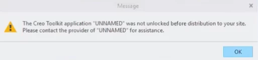

is Asynchronous application also need to Unlock?
I was testing my Asynchronous on my friend system then CREO shown this error. How I can disable this?
Nov 16, 2020 8:52 AM UTC
any Creo Toolkit application must be unlocked before you distribute it to users. This because Creo licenses used by users usually do not contain Creo Toolkit license.
