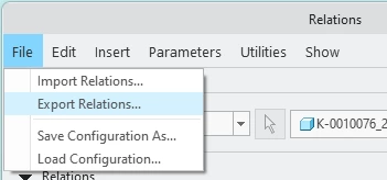

You can check this stone age guide of controlling parameters from excel. I am sure there are newer sources. Least painfull way I think is to use relations for every dimension you make. And then you just use simple macro for import/export.

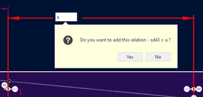

You probably know this part but just for info-- create a relation
and when putting value in dimension(when extruding for example) just write A and the dimensions will be dynamic.

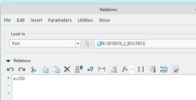

So your macro will be just importing .txt file from your other software with relations(depth,diameter etc..) like this
