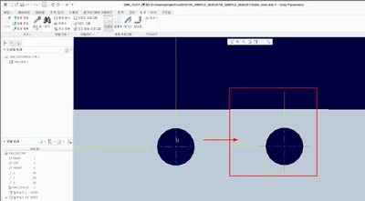

Is it possible to mark only one of the four axis directions in 2D to be selected?
When creating a dimension in 2D, Creo highlights one direction of the axis.
When select axis via ProSelect(), Creo highlights all direction of the axis.
Is it possible to highlights one direction(at cursor) of the axis when select axis via ProSelect().?

When creating a dimension by selecting an axis and an edge, if the direction of the axis is selected incorrectly, the dimension is not created as intended.
Therefore, we hope to emphasize the direction of the axis to the user.
The code is using the content of Article - CS339236.

ProSelect(...) is a generic selection function and it 'does not know' about drawing behavior specializations.
You need to use either pre-select or post-select arguments of ProSelect(...) to create a display list with highlights and to delete the list upon ProSelect() completion.
HIH.
