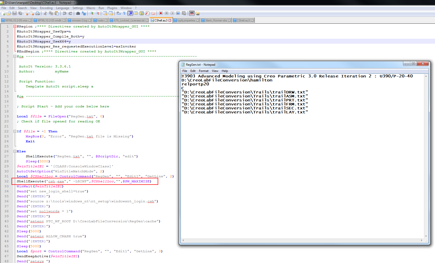

I want to convert Commercial creo lab files into Universal Format. While conversion Hamilton C Shell focus for every command.. It blocks the monitor . can't able to do any work simultaneosly on  machine.
I tryied using following commands. It only hides Hamilton C Shell Command prompt
   ShellExecute("csh.exe"," -LBINF",$CShellLoc,"",@SW_HIDE)  .
Manoj

Since you are trying to use "ShellExecute" I guess that you want to open C shell from a toolkit application. In the same time the syntax doesn't look quite right.What API are you using?

Are you trying to run a conversion program via the "open a system window" command in Creo Parametric where that system window is the Hamilton C shell?  Or are you running the normal system DOS/CMD window from Creo Parametric, and trying to execute an AutoIT script to run the conversion?
When you run a "system" window from Creo Parametric, the shell window must close/exit in order for control to switch back to Creo Parametric.
If you want to launch an external program via the "system" window from Creo Parametric, and still be able to use Creo Parametric while that program is running "in the background", try using the START command in a mapkey for launching the system window.
An example mapkey to start a system window would be:
mapkey run_convert @MAPKEY_NAMEConvert to Universal Format;\
mapkey(continued) @MAPKEY_LABELConvert to Universal Format;\
mapkey(continued) @SYSTEMstart \/min \
mapkey(continued) C:\\ptc\\scripts\\creo\\parametric\\convert_2_uf.exe;
The above mapkey will open a DOS/CMD window, start the convert_2_uf.exe program, and close the DOS/CMD window while the convert program will continue to run.
If you're not using a mapkey, you can still use the START command from the system window, and just close out the original system window once your program starts.
Hopefully I have understood your question.
Dan N.

I have created AutoIT Script for conversion which launches Hamilton C Shell on Desktop.
For every file Hamilton C Shell Focus on Desktop.
Is any option available to run process in Background.
