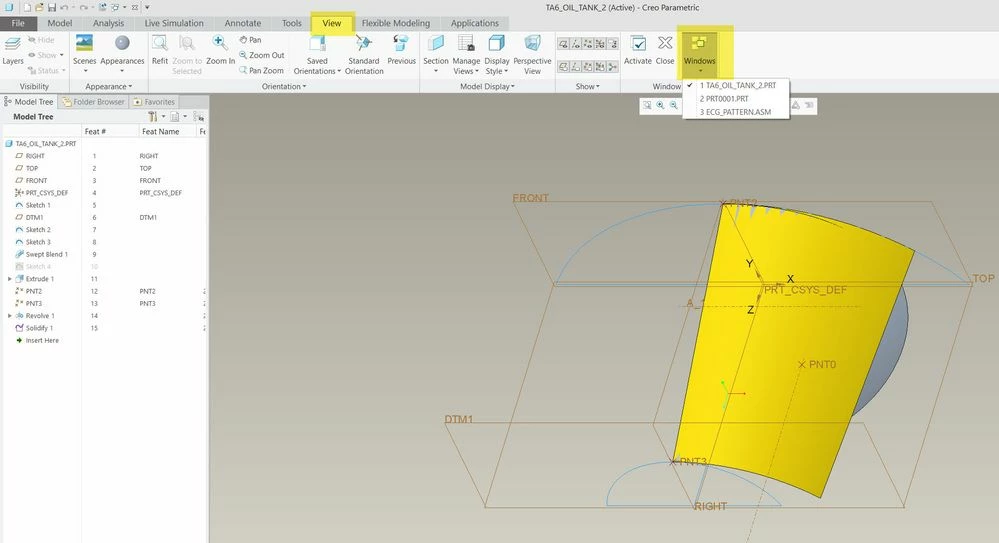

Hi, I have Logitech MX Master 3 mouse which in addition to 3 standard buttons (2 clicks and scroll) also has 3 macro buttons and roller (the other scroll). I'd like to assign these hotkeys to specific Creo features but the most important for me is to assign particular hotkey to the Creo "Windows" feature (in order to navigate between Creo tabs by mouse click). Is it possible to achieve this in Creo Parametric 6.0?
Thank you in advance for each answer!

It is possible to create a mapkey that will switch focus and activate an open window from a list of open Creo models (win1, win2, ....). If you only have two windows then it is possible to make a toggle to alternate them. If you have three or more then you will require a mapkey for each window.
I suspect you want to cycle through the open windows with a single mapkey and that is not possible using only a mapkey definition.
Are you aware that the UI has a list of current windows available for selection? You can make a mapkey to present that list for selection pretty readily and try it out.
View tab windows group listView tab windows group list
