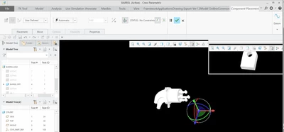

Is there any toolkit API for Component Placement?
I want to use toolkit to link a components list which corresponding .prt files are located in WindChill.
Once user choose one component from the list for assembly, after retrieving the model,
I want to let it in the Component Placement status like below picture. Would like to ask is there any API can achieve this? Thanks a lot.

Have you tried ProAsmcompAssemble ?
Also use ProAsmcompconstraintAlloc() with PRO_ASM_DEF_PLACEMENT

Thanks for your information, originally I tried the ProAsmcompCreateCopy(),
I will try to study your suggestion and look at the effect, thanks.

So you start the redefine UI ... you can simply add the change into mapkey and load it to the Mapkey Stack ... not a good solution, but it should work if you are in a synchronous app.
Br,
Eike
