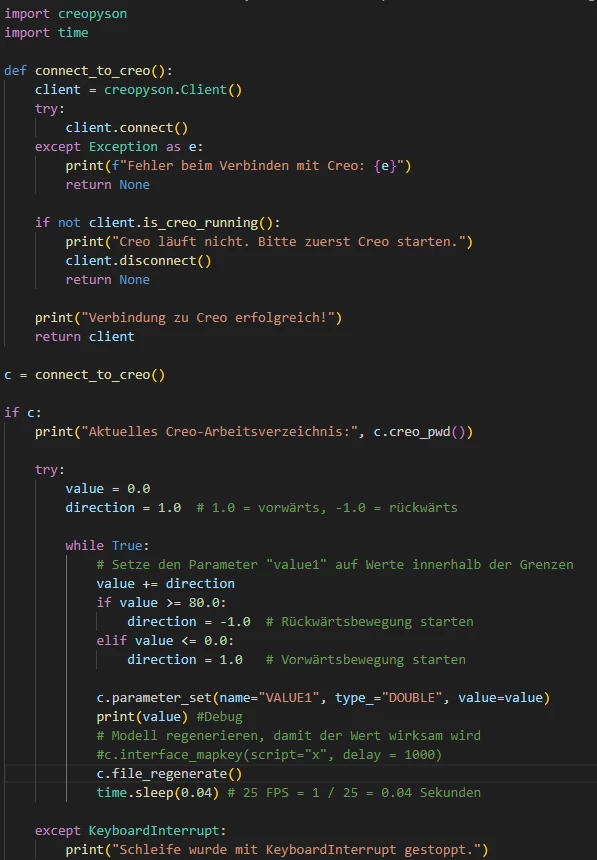

Hello forum members,
I am using Creo Parametric 10.0.7.0 together with Creoson and Python to create a (more or less) fluid animation. In the files you can look at my code.
My problem here is that whenever the value for the parameter is set and the regeneration is done the view changes so that the assembly is centered in the middle. Does anyone know how to do something against that?
I'm grateful for every bit of help, thank you.
