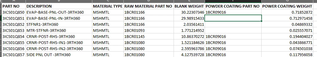

9-Granite
May 12, 2026 10:22 AM UTC
hi Dave,
Customer is looking for similar BOM format is this possible in nitro BOM they did try the free version of the same but not satisfied with the output.
Check the attachment.
Naresh
