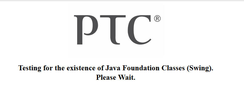

I cant seem to run index.html and API wizard  in jlink or weblink.  The idle error: Testing for existing Java Foundation Classes (swing). Please wait...
I have downloaded the latest java JDK 8 update 91 which comes with JRE.  But then i read that PTC supports 1.4.1 only

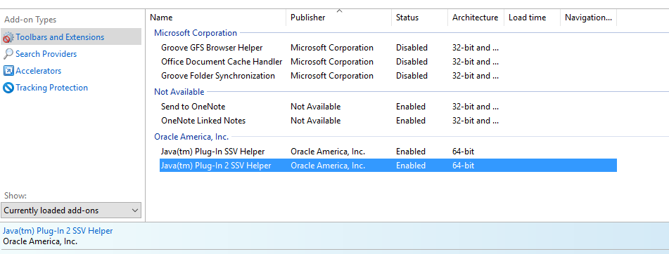

Check Your Internet explorer
Tools → Manage Addon. (Check highlighted add on available)
joe_c14-AlexandriteAuthor
Jun 7, 2016 2:43 AM UTC
Hi Parthiban
This is what i have in IE11.  I am missing the Java Plug-in..  I thought it would download automatically with the JDK kit 1.8.0_91 (64 bit)
I keep getting this error when opening index.html and API wizard
