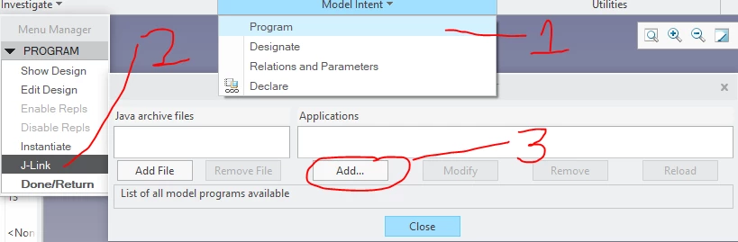

I read in the instruction manual that the code for the model needs to be loaded from the model itself.
Then I decided to consider an example for creo:
C:\Program Files\PTC\Creo 5.0.2.0\Common Files\otk_java_free\exercises\exercise_6
I compiled classes and put them in the creo working folder.

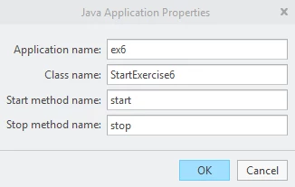

After which I wanted to add the class to the model as follows:
Pointed out the parameters of my class:

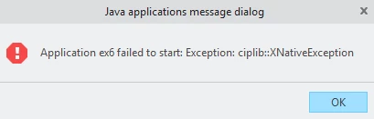

And got the following error:
Creo Version: 5.0.2.0.
Java version: jdk 11.
It seems to me that the error is not in the code, but in my actions. First I need to understand the following:
