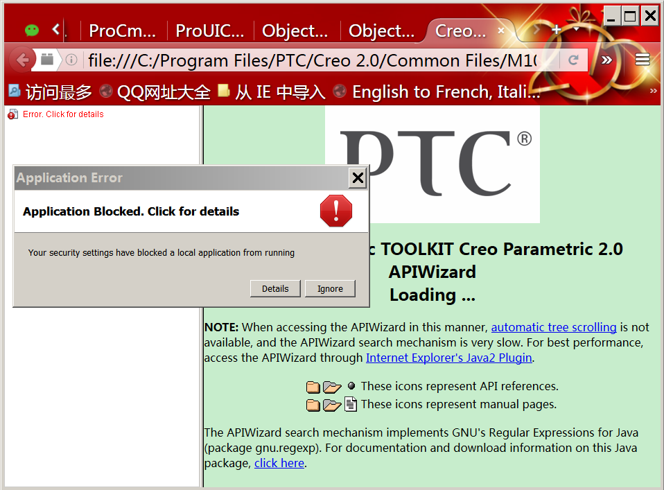

Hello all,
I encoutered a problem when I opened the proToolkit help file.
The error shows as follows, does anyone know how to solve it?
Thanks in advance.
I tried to install JAVA7 ,but also failed.
7 replies

Thanks for your answer.
I read these articles ,it seems the problem is solved only for Creo3.0, now I am using Creo2.0, so it seems doesn't work.

     Uninstall your java application and download Java 6. It is due to the java version issue. For creo 2.0 use java 6.
Java Archive Downloads - Java SE 6 using this link to download java 6 runtime.

You need to configure your permissions for Java applets.
Follow the instructions from this document created by Joshua Bryant‌

thanks for your help.
I will give up to run the java application.
