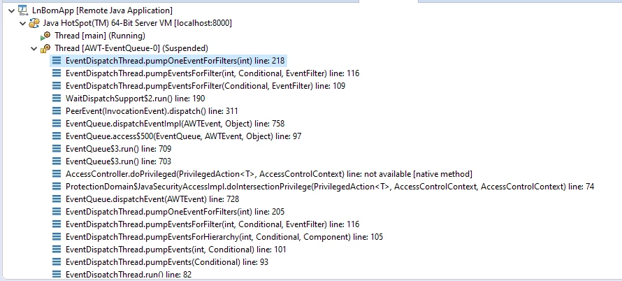

I try to write an application which creates an object with JAX-WS library, but Creo gives JAXBException.
The same code works very well in a standalone application.
I think that Creo cannot run JAX-WS libraries. I try to add jaxws library to the project manually but it does not work.

Check this
https://stackoverflow.com/questions/33783349/jaxbexception-not-a-valid-property-on-class-org-tempuri-billpull
I have not used JAX-WS yet, but I problem might be in your configuration.
I do not know how JAX-WS works, but if it creates thread which communicate with main thread it may cause problem, because jlink app in single-threaded and communication with any other thread may cause problems of whole application.
