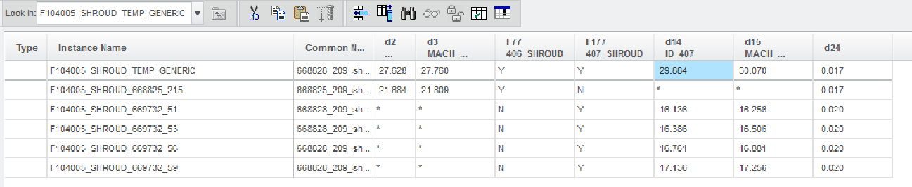

I am trying to extract the values of generics and instances in a family table using jlink api. I was successful in extracting the values of instances but not generics.
In the attached image , First row indicates the generic, Rest of the rows are instances.
Using the below code I am able to get the instance values but not generics.
Can any one let me know if there is any API to extract generic values.
Thanks.
ParamValue dimV = ((FamilyMember) proeModel).GetCell(colValue, row);

It looks like you treat the Generic Dimensions as Model Parameters not FamilyMember Items.

Mar 25, 2014 6:37 AM UTC
Thanks . This solved my problem.
But using this code I am able to retrieve only dimension values but not the feature values. For feature I am getting values as null .

I see what you mean, for some reason a Y/N response to a Feature is not the same as a Boolean YES/NO response to a Parameter. I think I have an idea but I need to try it out.
