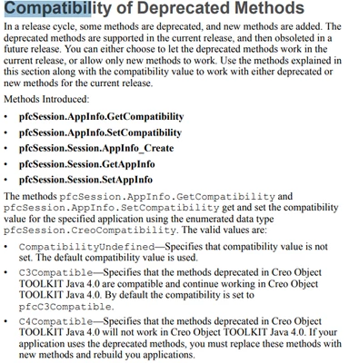

Aug 29, 2022 7:21 PM UTC
Have you tried messing with compatibility ?

Aug 29, 2022 7:58 PM UTC
Should have looked into Otk_Java_RelNotes.pdf
Creo 8.0.0.0 requires the latest version of JAVA 11 installed on your machine.
I downloaded Java 11.. Will install and test.
