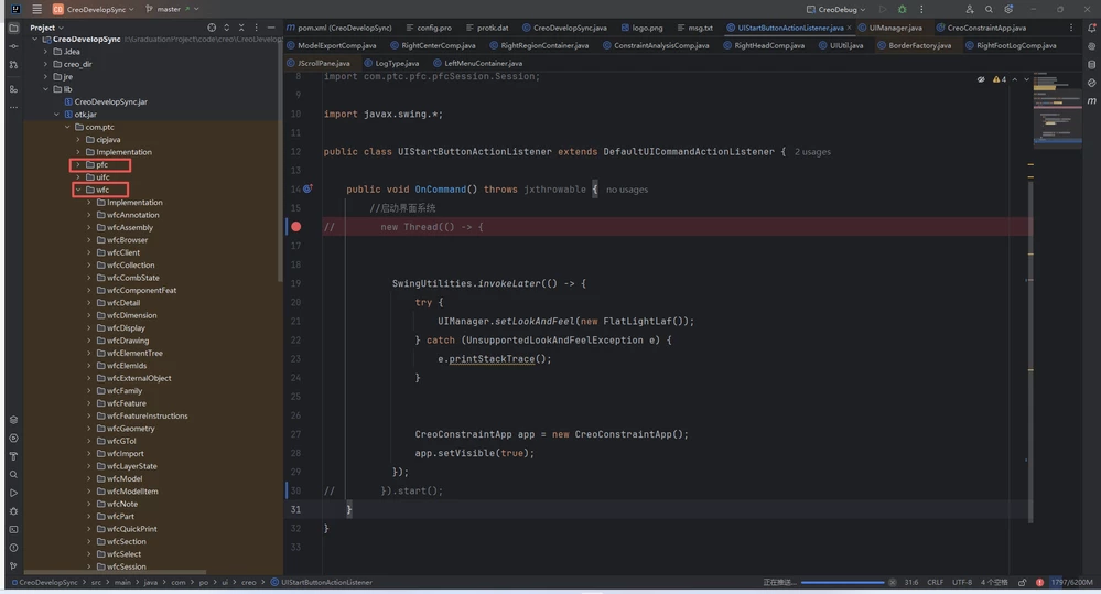

Hello, I want to perform a forced conversion of Assembly to WAssembly in the asynchronous invocation mode. Currently, I am relying on the pfcasync.jar. I noticed that there is no WAssembly in it. What should I do?
java.lang.ClassCastException: class com.ptc.pfc.Implementation.pfcAssembly$Assembly cannot be cast to class com.ptc.wfc.wfcAssembly.WAssembly (com.ptc.pfc.Implementation.pfcAssembly$Assembly and com.ptc.wfc.wfcAssembly.WAssembly are in unnamed module of loader 'app')

Sorry to ask, but what is a WAssembly?
Kzal5-Regular MemberAuthor
Mar 20, 2026 10:16 AM UTC
I want to use the wfc package to find that it only exists in otk.jar, but the asynchronous mode depends on pfcaaync.jar
RPN
18-Opal
Mar 20, 2026 10:23 AM UTC
Sorry but I’m not a Coffee Hacker but there is no similar wfcasyn package? Because in C there are 2 libs as well.
