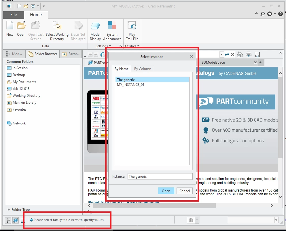

I want to load a model with JLink with "The generic" or with an other instance (1). For this see load_modell.png. In addition (2) I want to get all instances of a model.
(1) Load of a model with "The generic" or with an other instance:

When I load the model with "The generic" I set variable instance=null.
When I load the model with an instance I set variable e.g. instance="MY_INSTANCE_01".

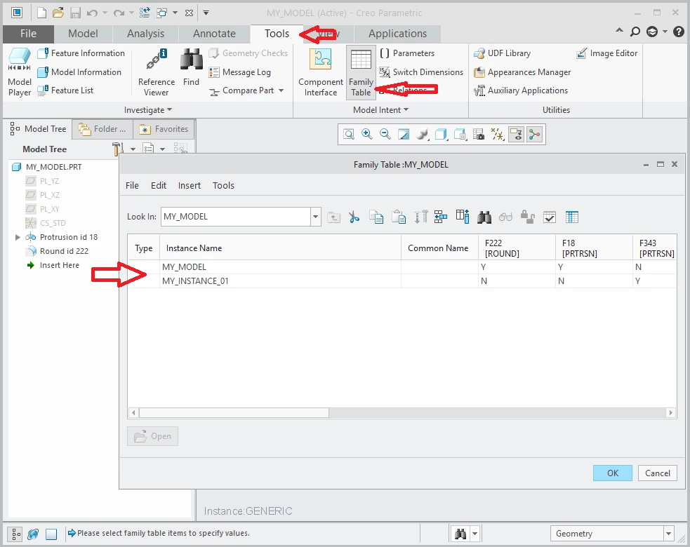

(2) Now I want to get all instances of my model. When I load my model in Pro/E-GUI manually with instance "The generic", I can get all variants using tools-->Family Tables (see load_generic_gui.png).
I think, I can get from this so loaded model all variants wirh JLink.

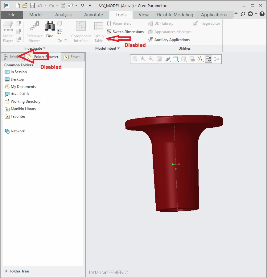

Now I load my model with my JLink programm. For this I set the variable instance=null. Unfortunately now the menu Tools -> Family table is deactivated (see load_generic_jlink.png), so I do not get the listed instances.
So my question: How can I get all instances of my model with JLink?
