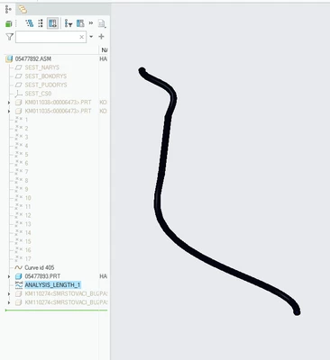

Model structure of most of our hoses looks like this

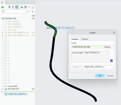

but for some reason when doing save as in windchill it does this to analysis feature
it measures only part of a curve (composite curve)
using JS API i need to get curve and check if it's a parent of a analysis but here comes an interesting part
when referencing part of a composite curve it still creates parent connection
how can i check if analysis references whole curve but not it's parts and in case of referencing only part of it repair analysis feature to reference whole curve
