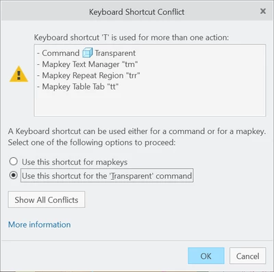

I'd like the "T" shortcut to permanently be mapped to a command, not a map key. So I click on the command option. However, whenever I restart Creo, it forgets my selection and this dialogue box appears again. How do I make it remember my selection by default (automatically)? I am running Creo 10.

The reason you are presented with this "problem" every time you start Creo is because it is loading the config.pro file with the conflicting mapkeys which start with "T". Comment out all of the conflicting mapkeys noted and then restart Creo; the issue should not occur. If this does not resolve the issue, then report back here with details of what happens.

Never use a single letter for a shortcut or mapkey!

Check this out -conflicts between mapkey and short cut keys:
https://community.ptc.com/t5/System-Administration/Mapkey-Shortcut-Key-conflicts/m-p/568901
