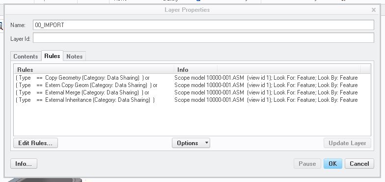

I have in my rule based layers a layer (00_IMPORT) that gathers import features.  The rules are:
Note that it only looks for features.  It works well, all my copy geom & merge features end up on that layer.

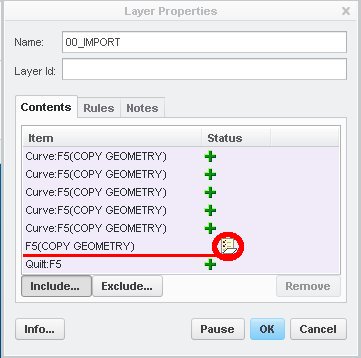

However, if I build an assy with sub assys and with dedicated skeletons at the sub assy level, I start to get quilts and other entities on that layer in the parts in the sub assy.  The quilts in particular cause problems.
For example, I create a quilt in the main skeleton A and publish it to sub-assy skeleton B. In skeleton B the copy geom ends up on my layer.  I then publish that quilt to part C.  In part C the copy geom and the quilt end up on the layer.  Because the quilts don’t follow the same rules as features and entities, I cannot show anything without getting the quilts too.
How do I stop these quilts (& other entities) from showing up?

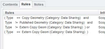

What happens if you exclude the External Copy Geoms from your layer rules just on part level? That is in your part C as you describe.
I've got this layer rule in my part template:
September 24, 2014
I think tht would accomplish the opposite of what I want.  I want the feature, but nothing else.  That's how the rulkes are specified - look for a feature, look by feature.

I reproduced the behaviour you described and I noticed something interesting. From the Content pane it looks like only the feature was added because of the rules. The green plus sign next to the entities means that the entity was added differently. The bad part is that I have no clue how.
Also I've noticed that if I remove everithing from the layer and then run the rules again only the feature get added.

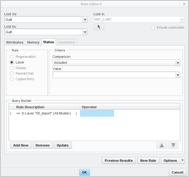

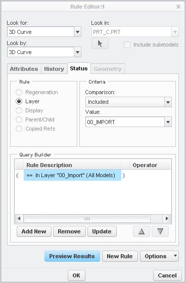

What it did work for me was to create the dedicated layers for quilts and curves and set the rules as follow:
Quilt layer:
Curves layer:
I attached a sample assembly. Look at the layer rules on prt_c.
