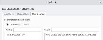

I’m having an issue with trying to get a User defined parameter PIPE_DESCRIPTION from the linestock to the piping start part parameter DESCRIPTION.
This is so when creating a pipe solid, each pipe part will have the PIPE_DESCRIPTION parameter value added to the DESCRIPTION parameter.
Then I can bring this into my table BOM, along with all the other fittings and parts which have the same parameter.
Is this possible or is there another way?
I'm using Creo Parametric 10.0.4.0

thanks, Ken, for your reply,
I've tried what you have suggested the issue here is the parameters needs to be within the same component, otherwise you get an error, unless there is something I'm missing in the relations function, as I'm only new to Creo.
Below image is where I'm trying to get the PIPE_DESCRIPTION parameter, as this is a common location for all of the different pipe types and sizes.
for example, if the pipe reducers, then another linestock is associated to that pipe segment, and other pipe solid part is created from a start part.
If that start part could read the linestock parameter and populate the DESCRIPTION my problem would be solved.
I would be happy to set up a Mapkey to grab the Linestock parameter then populate the description after the pipe solid has been created, however I don't know how to extract it from the User defined tab.
I've also tried breaking up the description as you have suggested, the issue here is that each would have to be populated manually every time something I'm trying to avoid again.
