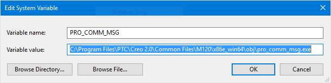

Jan 13, 2016 10:53 PM UTC
Hello John,
You are Environment variable setting is wrong, please change to PRO_COMM_MSG Instead of PRO_COMM_MSG_EXE. F083A0F3-0145-407A-BF28-4FD8ABCAAB86.png
Jan 15, 2016 7:03 PM UTC
If above trick not working
You set Both user & system variables for
PRO_COMM_MSG_EXE
PRO_DIRECTORY
