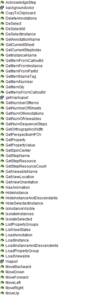

at the moment i try to insert a 3D View with creo view in Microsoft access. It will work with ActiveX.
But I dont know, how the commands works.
here are some commands in access for the activex plugin
