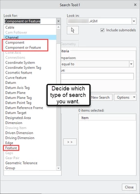

Macro i want select the FEATURE ID and not the node
I want to select a feature using a macro, but instead of writing ID FEATURE, Creo use the NODES.
Example:
mapkey(continued) ~ Select `main_dlg_cur` `PHTLeft.AssyTree` 1 `node3238`;\
Is it possible to write:
mapkey(continued) ~ Select `main_dlg_cur` `PHTLeft.AssyTree` 1 `feature ID 235`;\
Nov 28, 2022 2:10 PM UTC

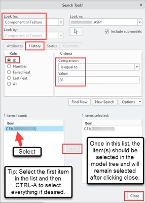

I do not know of a way to do it in one line, but it is possible to use the Search Tool (CTRL-F keyboard shortcut). It's a very useful way to select 1 or many items in the model tree via mapkey. You can uncheck the Include Submodels option if you don't wish to select subcomponents in the search results.

Try to use "Find" tool by ID.
