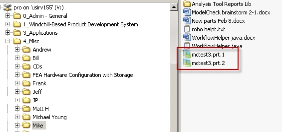

    Jun 19, 2012 11:17 PM UTC
    This mapkey seems to work perfectly to backup the current file (File, Backup), writing to the "V" network drive.

    [cid:image001.png@01CD4E36.F9190760]
    Seems that some code could be added to identify the mapkey name, instead of actually backing up the file - I just used that to see the result of writing to a network drive from within Pro/E.
