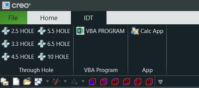

Click the icon to run the VBA development environment.
!VBA01 PROGRAM =======================================================================================
mapkey vb01 @MAPKEY_NAMEVBA PROGRAM;@MAPKEY_LABELVBA PROGRAM;\
mapkey(continued) @SYSTEMstart /B "" \
mapkey(continued) F:\\A_DEV\\TOOLBOX_VBA.xlsm;
!VBA01 ==============================================================================================
This is the icon displayed in creo.
There is no need to search for Excel files separately.
