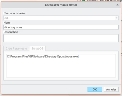

Hello all,
I have a mapkey (ex) that opens the windows explorer in the working directory. I have recently switched to directory opus as an alternative explorer. I would like to make a macro that launches directory opus in the working directory. Do you know how I could achieve that ? How would you do ?

Feb 12, 2026 11:05 AM UTC
I think this will help you a lot! You can change path to your dopus.exe instead of my batch file
mapkey xd @MAPKEY_LABELautoimport;~ Command `ProCmdDwgTblSaveasText` ;\
mapkey(continued)\ @SYSTEM "C:\\Users\\Admin\\Desktop\\personal\\autoimport\\tpv.bat";
RaphMORIN16-PearlAuthor
Feb 12, 2026 1:19 PM UTC
Thanks for the tip, but for now it doesn't work.
I wrote this in mapkey file
mapkey ed @MAPKEY_LABELOuvrir directory opus dans répertoire de travail;~ Command `ProCmdDwgTblSaveasText` ;\
mapkey(continued)\ @SYSTEM "C:\\Program Files\\GPSoftware\\Directory Opus\\dopus.exe";
It does open directory opus but not in the working directory.
I also get this message in the status bar in Creo :
14:18 Erreur de macro clavier : Invalid trail file line : No palette found for command 'ProCmdDwgTblSaveasText' in context 'context_main_dlg_w1'.RaphMORIN_0-1770902333408.png
