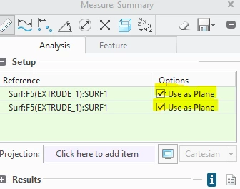

I am trying to measure the distance between two surfaces using ProGeomitemDistanceEval method which gives output distance as 0 always.
lErr = ProSelect("surface,point,axis", 1, NULL, NULL, NULL, NULL, &lpSelectionEdge, &lSelCount);
lErr = ProSelect("surface,point,axis", 1, NULL, NULL, NULL, NULL, &lpSelectionSurface, &lSelCount);
lErrCode=ProGeomitemDistanceEval(*lpSelectionEdge, *lpSelectionSurface, &distance);
Can you help what's the wrong in this code?
Thanks in advance.

Looks like you are passing the entire array instead of its element.
Check sample code:
 status = ProGeomitemDistanceEval(p_sel_arr[0], p_sel_arr[1], &dist);
 Should be
ProGeomitemDistanceEval(lpSelectionEdge[0], lpSelectionSurface[0], &distance)

Is there possible to measure the distance between surfaces without Use as plane option?
Feb 16, 2022 7:48 AM UTC
Not sure. Can you please check API "ProSelectionWithOptionsDistanceEval"
