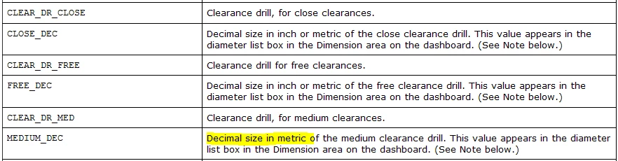

I have been trying to incorporate all callout notes for ISO and for UNC/UNF into two tables. This includes all of our applicable scenarios: Tapped, Clearance, C'BORE and C'SINK.
Did this by adding a DEFAULT_CALLOUT_FORMAT_DATA section to each table and it works brilliantly.
The only problem I have is that my UNC/UNF (INCH) table will not display the Medium Fit option when defining a Clearance hole.
The UNC/UNF (INCH) table (In Testing) was created after the ISO table was completed and deployed by doing a save as from the ISO table and updating the THREAD_DATA values.
Does anyone have any tips for resolving this issue?

Medium fit is only valid and displayed when the hole table is using metric units.
