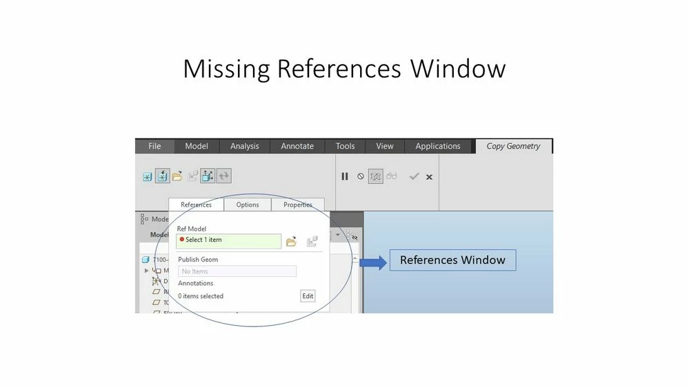

Something went wrong on my Creo Student version and I lost the copy geometry references window shown in the image below. Now I no longer can choose a published geometry.
What can I do to retrieve it? Is there a setting that I need to pick in-order to retrieve missing window or I need to reinstall Creo again?

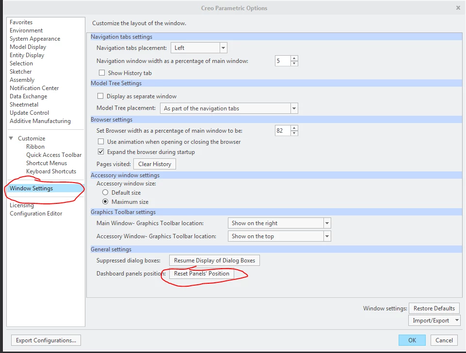

You need to gointo File > Options and then to Window Settings. There is a butto92bf4ef1-a52a-4109-b66c-a1e4a37fe1be.pngn to Reset the Panel Position.

It worked...
