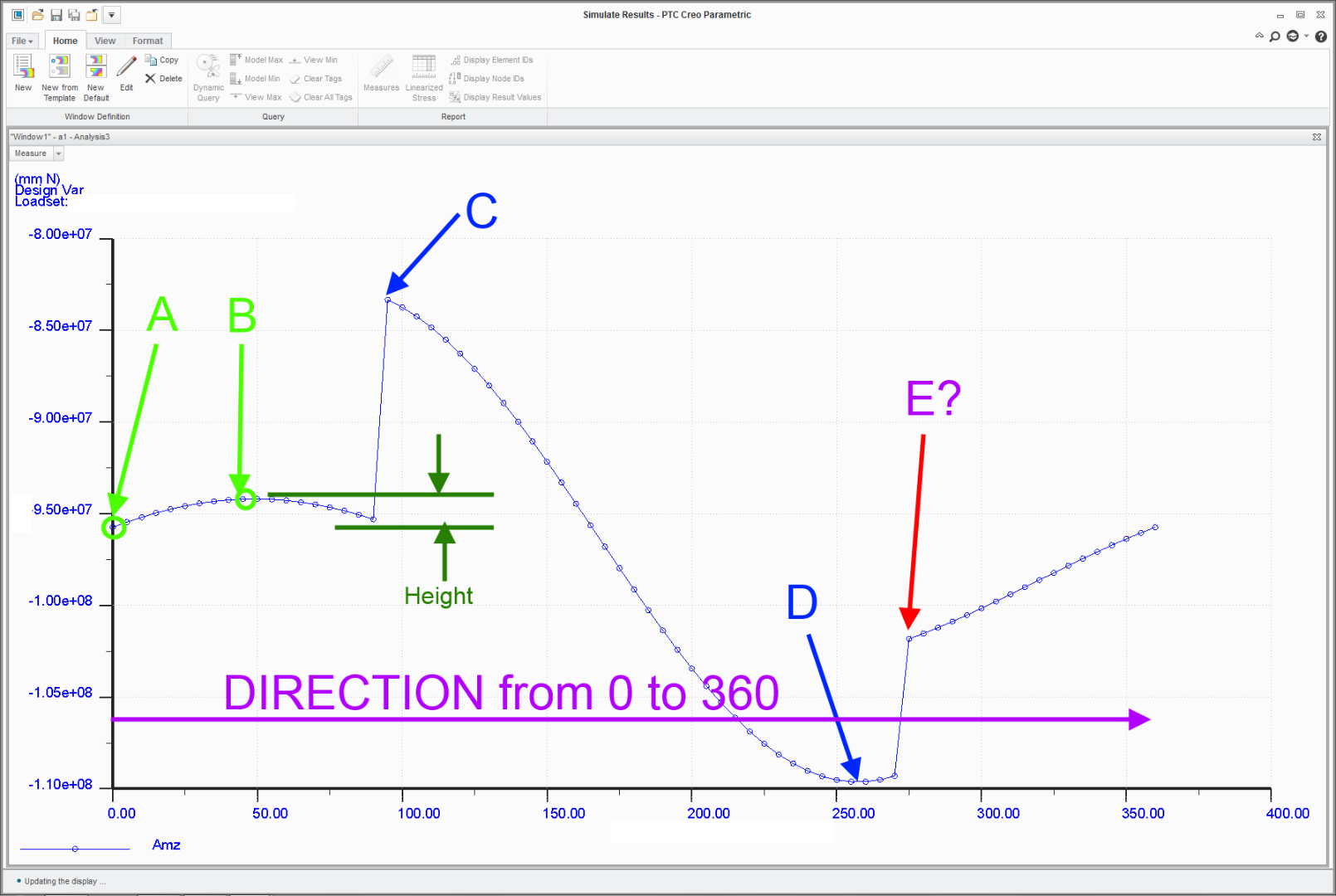

Bear with me, a fairly long question and based on the global sensitivity plot below
Can anyone suggest how to find C and D?
Is there a function that can be used as a computed measure in a global sensitivity study that stores the maximum or minimum value of another variable?
It is clear by visual inspection that the global max and min of the function is at C and D.
The optimiser will find A and B.
The reasons for this:
  • The x variable moves from 0 to 360.
  • The optimiser looks at the local gradient.
  • To maximise the function it starts at x=0 (A) and moves toward B because the gradient is +ve in that direction
  • Once it gets to B, all gradients are then -ve so it stops and reports the figure at point B
  • To minimise the function it starts at x=0 (A) and realises that moving to the right is a +ve gradient and therefore does not go toward B
  • The optimiser cannot go to the left and toward E in the direction of the downward gradient because the x variable given to the optimiser STARTS at 0 and progresses to 360. (even though it is part of the same curve segment when the graph is wrapped around because in my case, the x variable is angle in degrees, the optimiser cannot go below 0)

In the instance where the function height (shown in green) that A and B lie on is within the optimiser tolerance, the optimiser will put A and B are at the same location; at A. This may in of itself not be an issue because it is telling us that the function is flat and this is useful information. The optimiser realises that in order to change the value of the measure on this flat function it has to move a very long way from zero. It doesn't do this, the optimiser is short sighted and can't see the quantum leap to C because it's too far away.
Reducing the optimiser tolerance will find point B with more accuracy.

If the response curve is typical of all your geometries and loadcases, does it help if you run the optimiser twice, with start angles 180° apart, and take the higher/lower value from the pair using some fairly straightforward Excel?  Thinking a little more, this may not address the wrapping problem... but perhaps a further selective re-run of those cases that report either 0 or 360 as a max/min?

yes the response curve is typical. (96 of them) I didn't carry out 96 global studies, just 96 optimisations knowing that this is happening in the background. I was looking for ideas before going for the global studies.
I shall begin the optimiser 180 deg out for each case. 96 optimiser goals is easier than 96 global sens graphs.

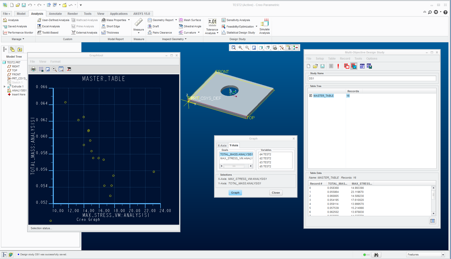

Creo Simulate's optimisers (GDP and SQP)  are not suitable for discontinuous goal functions. I vaguely recall that the BMX-module (Behavioral Modeling Extension) has some other optimisation techniques. It should be possible to reference a Creo Simulate analysis from BMX, and run the optimisation there. This could be worth looking into.
Aug 12, 2015 7:22 AM UTC
I have now played around a bit with the BMX. You can there do statistical design studies, i.e. "experiments" where you can make multi objective design studies. As I understand it, the default assumption is that design variables are uniformly distributed between their min and max, but my understanding after a few minutes of testing, is that you can also assign statistical distributions to design variables, and as a result, have the probability of stresses etc. exceeding a certain limit for example. Here's a screenshot of a very simple case: a plate with a hole. Hole diam and positions and plate thickness were altered uniformely distributed between their min/max. 16 experiments...
