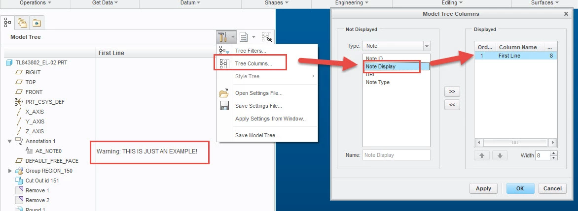

You have to add Note - first line to Tree columns.
Picture attached.

Thanks! how do you display the first line of the note?
mcestnik14-AlexandriteAnswer
Jul 11, 2018 1:48 PM UTC
Picture attached.
