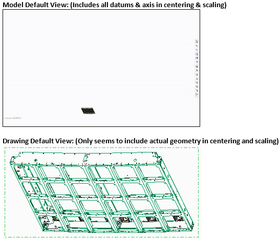

I have a user that is working with models that have curves with very large radii. When he does a refit (zooms so everything fits the screen) the part can sometimes disappear since the axis the radius is based on is so far away. Is there a way to just zoom in on the geometry?

Hi Andy,
I just did a quick search on this and it appears to not be possible.
https://support.ptc.com/appserver/cs/view/solution.jsp?n=CS53181

Thanks for the quick reply Clint. I will bring this up at the TC meetings and see what we can make happen.

That's why we have saved view.
I ran into another one yesterday...
I was saving views and as I changed simplified reps, the saved views were at different origins and scales.
All I want is solid geometry to fit on the screen. I also want my saved view to remember screen positions and zoom states.

Refit To Visible would be nice.

I agree. If it were Refit to Visible, then WYSIWYG and it would be intuitive (something PTC struggles with).
