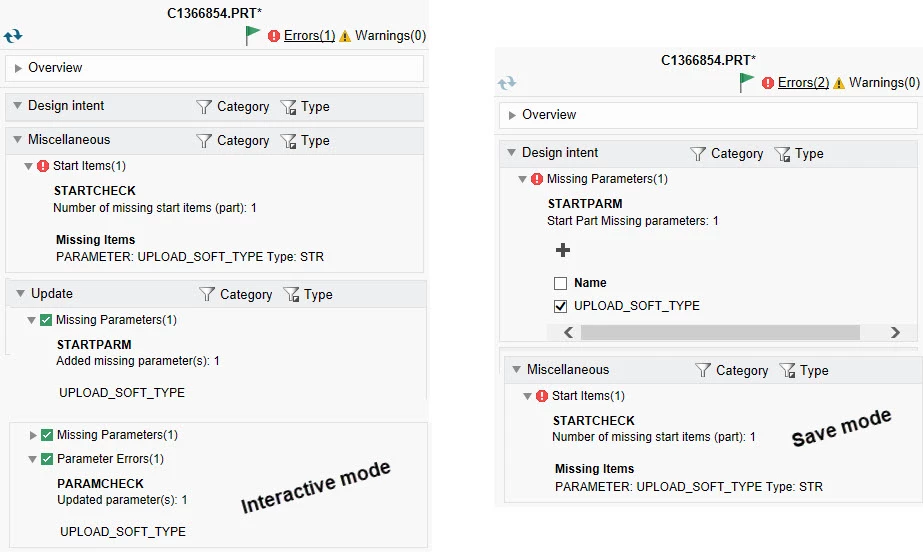

Start file (MCS) entries in my ModelCheck configuration folder:
PRT_PARAMETER MY_PARAM NONE EQ PDM
PRT_PARAMETER MY_PARAM STR EQ TEST1
This is working OK in Interactive mode,
MC creates the parameter as Designated:
Error message when running MC in Save mode:
Missing items PARAMETER: MY_PARAM Type: STR
(see the attached screenshot with results from Interactive and Save Mode)

Screenshots are already uploaded
