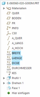

Is it possible to move a feature (feature) to any position in the model tree using Excel VBA?
E.g. the feature "Width" "Length" "Thickness" at the end of the model tree.
What would be the procedure here with Creo 5.0?

Thank you very much for the example, that was exactly what helped me a lot.
I always looked in the “Features” chapter but couldn’t find “GetFeatureByName()”.
Now I will try how I can find the last feature in the model tree.
I also noticed that there can't be a space in the "name".
GetFeatureByName("Fase 1")
"Chamfer 1" is not found because it contains a space.
gSession.SetConfigOption("regen_failure_handling", "resolve_mode")
Set solidModel = gSession.CurrentModel
Set feat = solidModel.GetFeatureByName("length")
Set aktFeat = solidModel.GetFeatureByName("profil3")
Set reorderOperations = New CpfcFeatureOperations
Set afterFeatOps = feat.CreateReorderAfterOp(aktFeat)
Call reorderOperations.Append(afterFeatOps)
Call solidModel.ExecuteFeatureOps(reorderOperations, Nothing)
Call solidModel.Regenerate(Nothing)
Set gOWindow = gSession.CurrentWindow
goWindow.Activate
goWindow.Repaint
goWindow.Refresh
Call gSession.SetConfigOption("regen_failure_handling", "no_resolve_mode")

I think, not possible to reorder features using VBA API.
But...
You can write a mapkey:
1. Find features by search tool by a name or ID
2. Select founded features
3. Place selected features to the footer
Run this mapkey from VBA
Nov 23, 2023 6:14 AM UTC
You can use this functions to reorder a feature
IpfcFeature.CreateReorderBeforeOp
IpfcFeature.CreateReorderAfterOp
HaGs10-MarbleAuthor

Hi YaroslavSin,
Thank you very much for your interest and your suggestions.
I have to test the mapkey to see whether “Moving to the End” works.
The possibility of:
I've tried it before but failed, you might have. an example ?
And how can I find the feature e.g. "width" in the model tree, in VBA?
