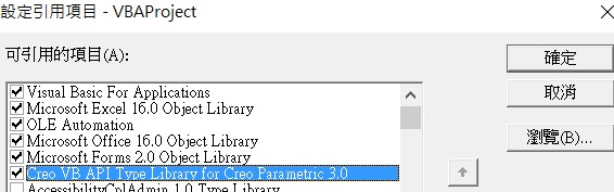

  1-3)   Creo Parametric VB API Type Library for Creo Parametric  =>Done

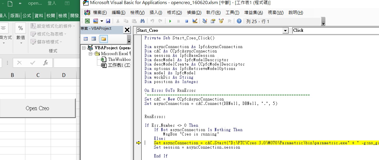

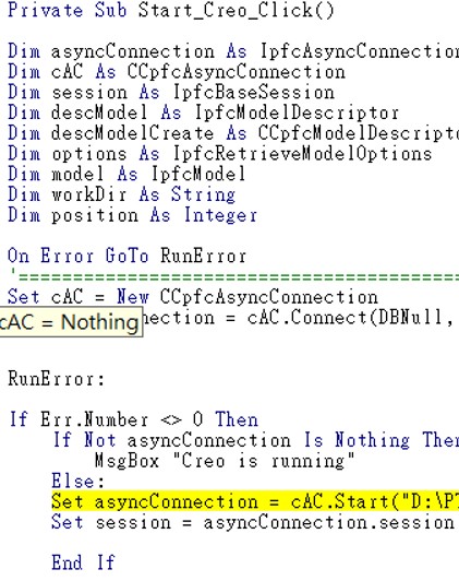

2) Here is the error message (code).
It shows cAC = Nothing .Why?
3) Here is my VBA Code.

Set cAC = New CCpfcAsyncConnection
Set asyncConnection = cAC.Connect(DBNull, DBNull, ".", 5)
